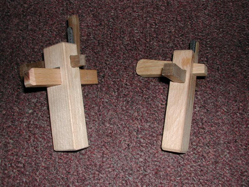

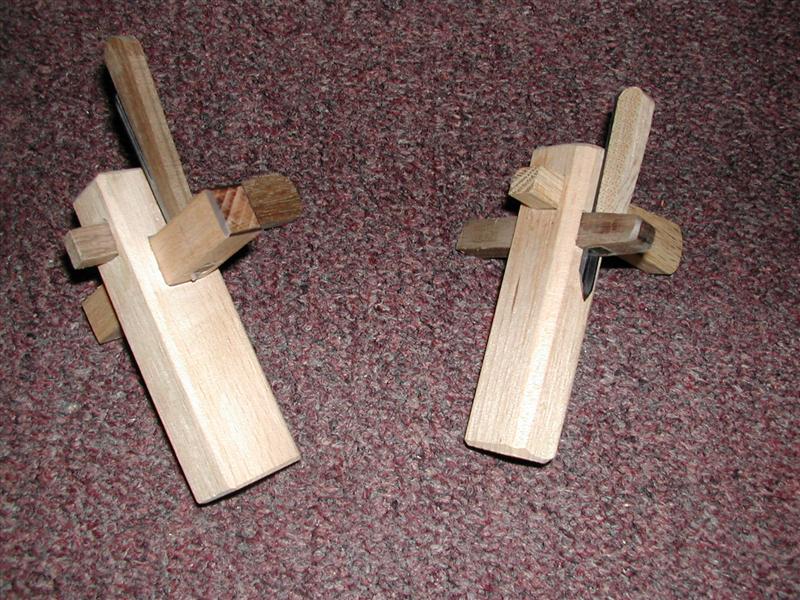

Since your a hand tool kind of guy, you can make a few of these binding cutters. Mr. O'brien made these for me. 2 shots taken of front and back.
Good luck!

The pictures Tracy posted are gramils. There are metal ones available from LMI one of our forum sponsors. I have this one. That and a good set of chisels, and you golden.

Hey Tracy do those use a Japanese marking knife as the blade?

[QUOTE=RCoates] Hey Tracy do those use a Japanese marking knife as the blade?[/QUOTE]
Actually, it is a japanese blade that was 6" long but cut in half and ground to the right shape.
